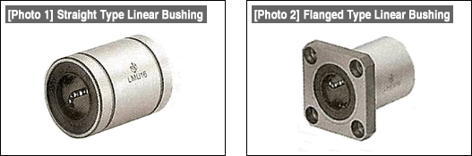

[Photo 1] is the Straight Type, and [Photo 2] is the Flanged type.
The Flanged Type [Photo 2] has the following advantages.

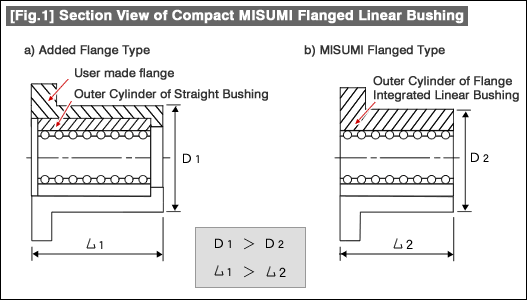

[Fig.1] is a graphical explanation of a MISUMI Flanged Linear Bushing. Adding a flange on a straight bushing will increase the housing diameter and length, but the flanged linear bushing is compact since the bushing and an outer cylinder are integrated into one structure. A compact design is possible while retaining load bearing capacity.

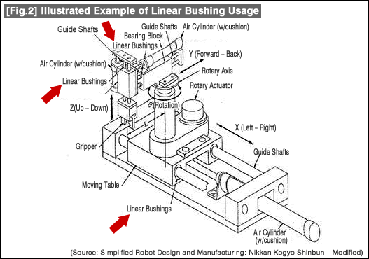

Linear bushings can be used as the moving structure or as stationary bearings where the shafts move. [Fig.2] below is a multi-axes X-Y-Z-Theta stage, and each axis can be analyzed as follows.
In the illustrated case, the X-axis moving linear bushings on section a) will need to be mounted securely since they bear the inertial forces of the moving mass. On the section b), the housing mounted linear bushings only receive the reaction forces of the friction from an air cylinder driven shafts. Therefore, a compact design using the Straight Bushings is adopted. Furthermore, the opposing layout of dual shafts against the rotary moments of the Theta axis enables the use of Straight Bushings with sufficient rigidity. The c) section can be considered as the same as the b) section in terms of the shaft moving direction, and no large forces apply.

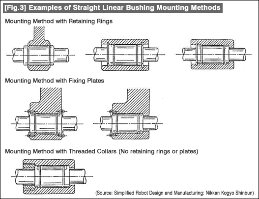

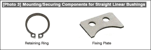

Straight Linear Bushings are mounted/secured using Retaining Rings or Fixing Plates. (See [Photo 3] & [Fig.3])
Linear Bushings" name="image" width="527" height="175" />
![[Fig.3] Examples of Straight Linear Bushing Mounting Methods](http://www.misumi-techcentral.com/tt/en/lca/images/059_zu3.gif)
