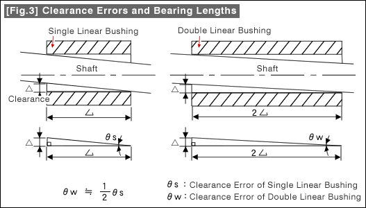

b)Relationship of Bearing Length and Guiding Accuracy
Following accuracy improvements can be expected as the bearing length increases.
a)Shaft errors are averaged and accuracy is improved (Averaging Effect: see Notes)
b)Effects of shaft/bearing clearances are reduced and accuracy is improved ([Fig.3])
Averaging Effect: Errors are reduced to 1/2 or less by increased bearing length averaging the surface error elements (surface roughness, bumps, undulations).

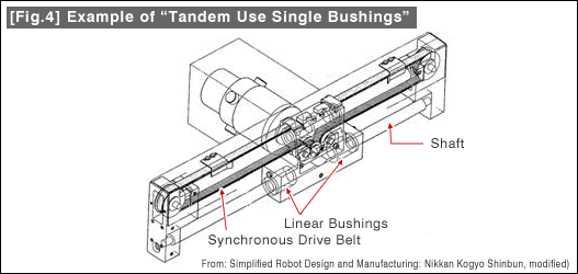

Therefore, load capacity and accuracy can be improved by increasing the bearing length. The [4] Tandem Use Single Bushings are sometimes used for relatively high accuracy applications for this reason.
[Fig.4] Example of
