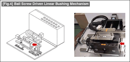

(2) Stepping Motors and Ball Screw Drive
| ・ | Ball screws provide good transmission efficiency and utilization of motor efficiency since [1] they directly convert motor's rotary motion into linear motion, and [2] the screw pitch works as a deceleration mechanism. | |
| ・ | [Fig.4] is a drive mechanism with ball bushings and a ball screw drive on the Y-axis, typically used where reduced cycle times and increased positioning accuracy are needed. |
![[Fig.4]](http://www.misumi-techcentral.com/tt/en/lca/images/062_1.gif)

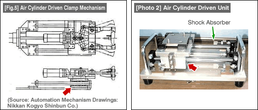

(3) Air Cylinder Drive
| ・ | [Fig.5] is an air cylinder driven guide bearing of a clamp mechanism, and [Photo 2] is a magnetically coupled air cylinder mechanism. They both use linear bushings (arrow leader). | |
| ・ | Since the air cylinders cannot be velocity controlled during acceleration and deceleration, shock absorbers are used to reduce the shocks when stopping ([Photo 2]). |
![[Fig.5][Photo 2]](http://www.misumi-techcentral.com/tt/en/lca/images/062_3.gif)

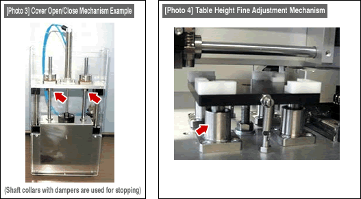

(4) Vertical Guide Example
| ・ | For vertical guiding applications, use of flanged linear bushings can achieve compact and simple mechanism without dedicated retaining mechanisms provided. (Linear Guides require a vertical base plate for guide rails) |
![[Photo 3][Photo 4]](http://www.misumi-techcentral.com/tt/en/lca/images/062_4.gif)

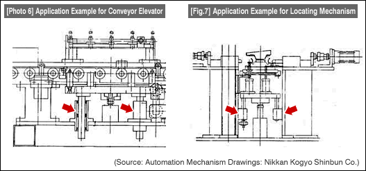

| ・ | Flanged linear bushings are also used for elevator mechanisms for transfer conveyors ([Fig.6]) and locating mechanisms ([Fig.7]), similar to the mechanism in [Photo 4]. |
![[Photo 6][Fig.7]](http://www.misumi-techcentral.com/tt/en/lca/images/062_5.gif)
