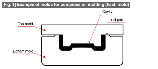

Male and female molds are prepared, the molding resin is loaded inside the female mold, the male mold is closed, and the set of molds is heated thereby solidifying the plastic resin and preparing the molded article.
At the time of closing the male mold, excess resin overflows from the parting surface and becomes burrs. These burrs are removed after molding. (Fig. 1)
