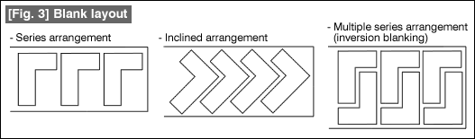

The arrangement of blanks during blanking work is called the blank layout (how blanks are taken from a plate). Some examples of this are shown in Fig. 3. The rate of utilization of the material differs depending on the arrangement. The arrangement is selected so that the material is not wasted.
![[Fig. 3] Blank layout](http://www.misumi-techcentral.com/tt/en/press/images/012_3.gif)
