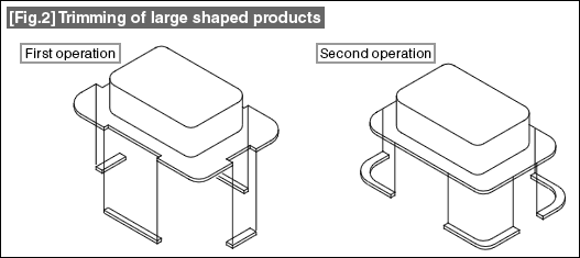

If the product becomes large, the scrap will be too large and even if removed from the die by dividing it into two parts, very often the processing thereafter (recovering by sliding above the chute, etc.,) cannot be done well. It is good that the scrap is made into appropriate sizes that make their processing easy. Fig. 2 shows such an example. The size of the scrap is made small using two steps thereby making the processing easy.
In shaping operations, attention is given strongly (of course, naturally) to the formed shape, and problems can occur if trimming and scrap processing is taken lightly. Care should be taken about these.
