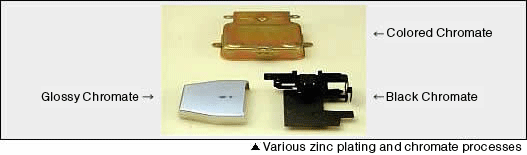

| Zinc PlatingPlating bath types- Cyanide Bath- Zincate Bath- Acidic Bath | Due to the anti-corrosive property of zinc (Zinc is well known as a sacrificial anode of steel. This is because zinc's single electrode potential is less noble in comparison to iron, and the zinc dissolving before the iron prevents iron from dissolving.) and the anti-corrosive nature of the chromate process over the zinc plating, this is often used as anti-corrosive plating for steel.This is a zinc plating bath customarily has been in usage, and is used for press formed components, bolts & nuts and etc.  It has good plating thickness uniformity and post plating machinability.  The cyanide bath contains highly toxic cyanide, and the alternative bath containing no cyanide has harder plate coating than the cyanide bath.Compare to the two alkaline baths listed above, this has better electric current efficiency, and and steel and cast iron can be plated. Also, it causes little hydrogen embrittlement. |

| Zinc-Iron Alloy Plating | High corrosion resistance as listed above.  Colored chromate processed plating has 5 micro-meters of coating thickness and withstands 2000 hours or more of salt water spray test.  Glossy, colored, or black chromate process can be selected. |
