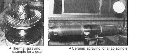

Thermal spraying example for a gear,Ceramic spraying for a lap spindle
