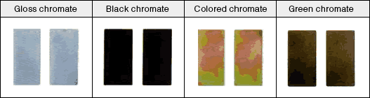

Chromate treatment process [Figure] and types and characteristics [Table] applied over zinc plating (some cadmium plating also) are shown.
[Fig.] Zinc plating chromate treatment process
Fig.
[Table] Outline of various chromate treatments
VarietyTypeExterior color toneApplication area
Gloss chromateFor exterior appearanceSilver blue whiteUse where emphasis is on the aesthetics rather than the corrosion resistance as much.
Anti-corrosiveBlue~Light YellowUsed where the anti-corrosion property is most important.
Colored chromate Gold, RainbowUsed where the anti-corrosion property is further emphasized.
Black chromateFor exterior appearanceBlackGood corrosion resistance. Often used for ornamental purposes. Used where anti-wear property is not of importance.
Anti-corrosiveBlackUsed where corrosion resistance and weather resistance are of importance.
Green chromate Olive colorApplied on parts used in highly corrosive enbironments.
Corrosion resistance example of various chromate treatments are shown in the [Table] below. The "white rust" is zinc oxide.
[Table] Corrosion resistance of various chromate treatments (Number of white rust spots, Test specimen 5 pcs.)
 Salt water spray time (H)
Coating24487296120144168192216〜500
Gloss chromate0245
Colored chromate0000245
Black chromate0000025
Green chromate00000000002
