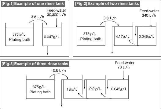

In general, "water washing" is performed in a rinse tank while running a small amount of water into it. In this process, the plating solution attached to the product will be dispersed into water when you soak the product into a rinse tank.
A rinse tank unit consisting of two to three tiers instead of one tank is used for this water washing process. In this process, the product is supplied from one side while fresh cleaning water flows from the other side. This method is called "countercurrent multistage washing". In this method, the water of the uppermost stream is always clean even when the water on the bottom of the rinse tank is heavily contaminated.
Now, let's calculate the amount of water required for washing and cleaning in the following conditions:
[Fig.1] shows the example of using one rinse tank. [Fig.2] is the example of using two tanks. [Fig.3] is the example of using three tanks. The rinse water amount, which was 30,300 L/H for one tank, is reduced to 340 L/H for two-tier washing. If you use three tanks, the water required is only 76 L/H. These examples conclude that multistage washing is effective in reducing the water usage drastically.
![[Fig.3] [Fig.2] [Fig.3] [Fig.3] [Fig.2] [Fig.3]](/tt/en/surface/252.gif)
