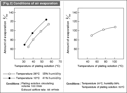

The second characteristic is that relatively thick plating solution separated by spray cleaning can be restored back to the plating bath as long as the amount is within a range of natural evaporation from the plating bath. The amount of natural evaporation increases when the operating temperature of the plating bath is relatively high. As shown in [Fig.1], the plating solution can be collected easily under this condition.
If it is not possible to restore the entire plating solution collected due to insufficient evaporation volume, collect them by forcibly vaporizing the separated solution. To vaporize plating solution forcibly, adopt the "air evaporation" method used for cooling towers. At this time, the heating unit of the plating bath supplies latent heat of water evaporation.
When the solution has low bath temperature or is likely to dissolve, the batch-type vacuum evaporation can be also adopted.
Evaporation of the plating solution is significantly affected by its temperature and circulating volume, exhaust airflow rate, external temperature and humidity, etc.[Fig.2] shows the conditions of evaporation.
