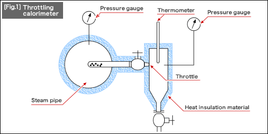

The dryness of steam, which is an important factor for boilers, can be measured by using a throttling calorimeter as shown in [Fig.1]. Just like the figure, insert a tube with holes into the steam pipe and measure the temperature and pressure of the steam passing through the throttle. Based on these measured values, you can find out the heat quantity and compute the dryness X using the steam table. As you can see, the heat retention control for steam piping is extremely important during steam transport in terms of the dryness control as well.
Heat insulation tubes made of glass wool are generally selected for heat retention control of steam piping. Adopting a thicker heat insulation layer can improve heat insulation, but it will be more costly. As a middle ground between the cost and effect, heat-insulation materials of 25 to 100 mm thickness are commonly used. Realistically, you cannot reduce the piping heat loss to zero. It is also important to remove drained water generated in the pipes.
