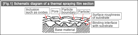

(1)Characteristics of the films
The structure of film sprayed in the air is extremely complex and has the following characteristics:
| 1. | It is a buildup of particles having boundaries. | |
| 2. | It has pores. | |
| 3. | It contains oxidation products. | |
| 4. | Residual stress exists. | |
| 5. | The material and film compositions may change before and after thermal spraying. | |
| 6. | Both unmelted and semi-molten particles may be present. | |
| 7. | The film has a rough surface. | |
| 8. | The films are mainly bonded mechanically, but metallurgical bonding may occur depending on the spraying method. |
[Fig.1] is the schematic diagram of a film structure.
![[Fig.1] Schematic diagram of a thermal spraying film section [Fig.1] Schematic diagram of a thermal spraying film section](/tt/en/surface/138_1.gif)
