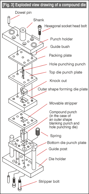

On the contrary, since the structure becomes complex, there is the drawback that the number of steps of preparing the die becomes large. For the sake of reference, an exploded view drawing of a compound die is shown in Fig. 3. It is obvious that the structure is quite complex. In this figure, the knock out and compound punch are compound parts arising out of combined processing operations. The knock out has the functions of ejecting the product and of a hole punching stripper. The compound punch is a combination of a punch for outer shape blanking and a die for hole punching. These two parts will have almost the same shape as that of the product. Therefore, the die does not function if these tow products become weak and break.

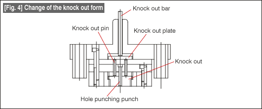

Although the discharge of the product from the die is done by the knock out, because of the hole punching punch it cannot be formed in the mode of Fig. 2, but very often it will have a structure of the form shown in Fig. 4. It can even be said that the form of Fig. 4 is the more standard one.
Fig. 3 Exploded view drawing of a compound die
Fig. 4 Change of the knock out form
