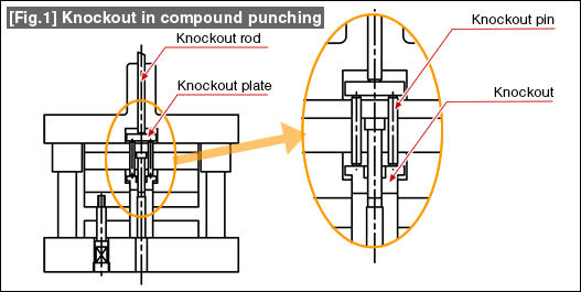

The die structure in compound punching is shown in Fig. 1. This is a structure in which the die for outer shape punching (blanking) is in the top die. This type of a structure is called an "inverted placement structure". In the inverted placement structure, the product after outer shape punching enters the die in the top die. Since the top die is attached to the slide of the press machine and carries out up and down movement, if the product that has entered the die is not ejected well, it can lead to breaking of the die. The die component for ejecting the product that has entered into the die is called a knockout. This is a characteristic component of the inverted placement structure. Although the inverted placement structure is used quite often for drawing other than punching operations, the work of the knockout is the same.
(1) Knockout structure of the die
Recently, the action of taking out a product from the die is very often called as "ejecting". However, this action is frequently called "knocking out" in press forming operations. Either way is acceptable. However, the die component used for this action is called a "knockout". The structure of a knockout is explained using Fig. 1. The knockout is present inside the die. The knockout is prepared in almost the same shape as the die. A flange, etc., is provided to prevent it from falling off. When the outer shape is punched from the material, the knockout is pushed up along with the removed material. Near the top dead center, the knockout is pushed from behind, and returns to the shape before carrying out the outer shape punching, thereby ejecting the product. The components pushing the knockout from behind are the knockout pin, knockout plate, and knockout rod. Depending on the structure of the die, sometimes the structure is such that the knockout is pushed directly by the knockout rod. The press machine applies force to the knockout rod.
