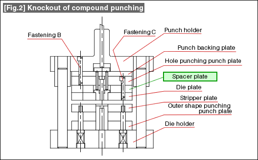

Fig. 2 shows a plate configuration in which the die plate is divided into two.
This is used when the underside counter boring for the knockout is cumbersome, or when it is wanted to save the material of the die plate. Although the name of the plate produced out of dividing is called here as the spacer plate, it is also called by other names such as "play plate", etc. Since this plate is for making the knockout movable, the material used is S50C or SS400. Since the number of plates becomes large in a die for compound punching, sometimes the die is prepared with some special techniques in its design. This is the method used when the die is prepared by wire cut electric discharge machining. If the die plate is prepared by wire cut electric discharge machining, although the material inside the die is cut away, this material is used as the punch. With one single plate, it is possible to prepare the punch and the die. When the plate is thin, the die is prepared using taper machining of wire cut electric discharge machining.
Similarly, at the time of preparing the stripper plate, the material that is cut away is used as the knockout. If such techniques are used, while the die material can be saved, at the same time, even the preparation of the die becomes faster. This is suitable for the production of small volumes. The number of plates becomes large in the top die of a compound punching die. Although this is a method of using bolts and dowel pins (knockouts) as was shown by "fastening A" in Fig. 1, the number of penetrating plates is large and hence one might feel that there are problems in reliability. This is more so when a spacer plate is used. As shown by "Fastening B" and "Fastening C" in Fig. 2, in some cases, the die plate and the punch plate for hole punching are integrated together, and the fastening as the top die is made separate. While the dowel pin is the component that determines the positional relationship, the reliability becomes poor as the pin becomes longer. It is considered good if the number of plates that the dowel pin penetrates is about three.
The method of fastening and the work of assembling the die are related to each other. It is necessary to select the fastening considering the fastening of plates as well as the operation of pierce punch spotting of the die.
