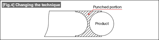

The metal forming method of punching can be said to have a die structure with which it is easy for bending to occur. In the technique shown in Fig. 4 in which the part that becomes the scrap is removed and the product is left on the die, since it is possible to carry out the forming while constantly pressing the material, it is possible to make bending small (in this case, even warping can be made small). This method is being used widely in the case of products in which a high degree of flatness is required.
