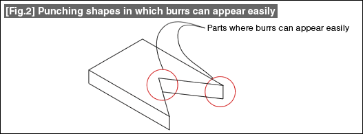

Burrs become small when an appropriate clearance is used. Therefore, the clearance is set so that it becomes uniform for the shape being punched. This is the basic attitude when preparing a punching die. However, even if a uniform clearance is set, there are shapes in which burrs appear quickly. As shown in Fig. 2, this is pronounced at the apexes of sharp projection or recess parts, which are followed by corners that do not have rounding.
The cause of this is the chipping of the corners of the punch or the die. Chipping occurs due to combined effects of the shape and the punching conditions. Even when an appropriate clearance is used, the punching conditions are bad in the corner parts (the punching conditions will be similar to when the clearance is small), and the cut surface will not be normal. The countermeasure is to make sure that the punching conditions are the same as in the straight line parts. There are two methods for this, one of which is to round the corners (corners with an R of 1/2 of the material plate thickness or more), and the other is to increase the clearance.

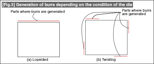

Burrs are also generated due to the relationship between the punch and the die. This is shown in Fig. 3.
Lopsided and twisted clearances are the commonly found phenomena.
The checking of the clearance of a punching die can be made by punching a paper or vinyl sheet. A paper or vinyl sheet is placed on the die, the punch is stopped just when it has entered into the die by a very small amount, and the condition of punching of the paper or vinyl sheet is inspected. The parts that have been cut neatly are the parts where the clearance is small. The clearance is large where the fibers of the paper are remaining uncut or where the vinyl sheet has been cut so that it is stretched. Adjust so that the cutting is uniform.
