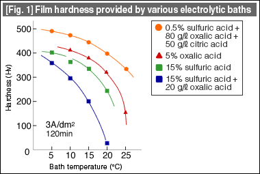

(1) Bath temperature and film hardness
The typical hardness of the films produced at different temperatures of various electrolytic baths is shown in Fig. 1.
![[Fig. 1] Film hardness provided by various electrolytic baths [Fig. 1] Film hardness provided by various electrolytic baths](http://www.misumi-techcentral.com/tt/en/surface/images/093_01.gif)
The graph clearly reveals that the film hardness varies significantly depending on temperature and types of electrolytic baths. As a result, the method in which the electrolytes of sulfuric acid and organic acid are industrially used (mixed acid method) and electrolysis is performed at low temperatures close to 0°C is in the mainstream.

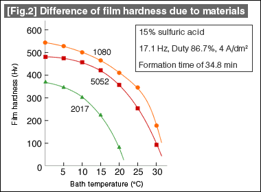

In addition, the properties of the anodic oxide film are significantly affected by the composition, heat treatment, working history of the raw material, and the aluminum alloy. Therefore, even if electrolysis is performed using the same electrolyte and under the same conditions, a different raw material cannot provide a film with the same properties. The relationship between the material and film hardness is shown in Fig. 2. This graph is based on periodic reverse electrolyzing developed by Keigo Okubo.
![[Fig.2] Difference of film hardness due to materials [Fig.2] Difference of film hardness due to materials](http://www.misumi-techcentral.com/tt/en/surface/images/093_02.gif)

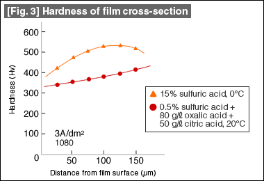

(2) Hardness of film cross-section
Fig. 3 shows the hardness distribution of the hard film cross-sections. As the film thickness increases, the initially produced film surface in contact with the electrolyte is provided with the porous property due to dissolution by electrolytes, resulting in lower hardness.
![[Fig. 3] Hardness of film cross-section
15% sulfuric acid, 0°C [Fig. 3] Hardness of film cross-section
15% sulfuric acid, 0°C](http://www.misumi-techcentral.com/tt/en/surface/images/093_03.gif)
