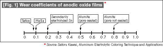

(4) Wear coefficients of anodic oxide films
Fig. 1 is a summary of the wear coefficients of the anodic oxide films described above:
![[Fig. 1] Wear coefficients of anodic oxide films* [Fig. 1] Wear coefficients of anodic oxide films*](http://www.misumi-techcentral.com/tt/en/surface/images/094_02.gif)
