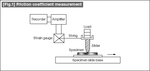

(11) Friction coefficient measurement method
Lubricants strongly adhering to metal surfaces lower friction coefficient. Similarly, existence of organic substance, or contaminants also alter the friction coefficient.
This principle can be used to measure the friction coefficients by using a slider on contaminated metal surfaces as shown on [Fig.1] by converting the force acting on the slider into friction coefficient by a strain gauge. The amount of lubricity by the contamination is determined by varying the loads on the slider and by obtaining friction force variations over time.
