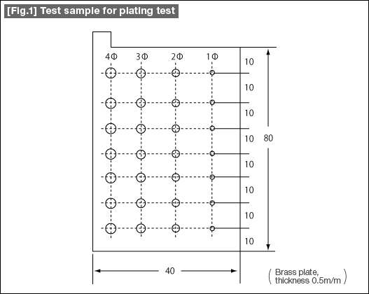

For surfaces treated with oil based grinding compounds, residual oils remain on the treated surfaces as thin films. These surfaces must be completely degreased and the method to evaluate the difficultness of this is to use a test sample shown in [Fig.1] and Fuff polishing >> alkali degrease >> bright nickel plate >> then evaluate. The plated surface incompletely degreased will show with lost glossiness with residues and fingerprints clearly visible.
![[Fig.1] Test sample for plating test [Fig.1] Test sample for plating test](http://www.misumi-techcentral.com/tt/en/surface/images/114.gif)
The reason for the various sized holes on the plate is to make the level of degreasing by observing differences due to fuffing heat and buff compound residue adhesion.
