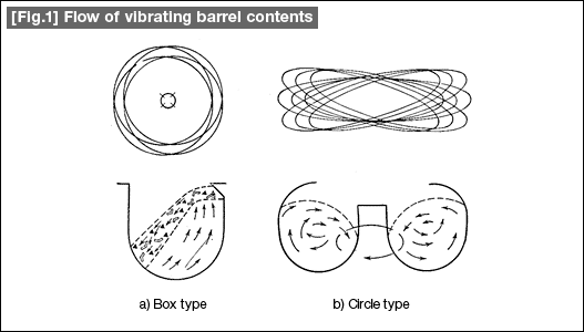

Vibrating barrel polishing is a method of applying zigzag motion and high cyclic vibrations on barrel contained parts and polishing agents.

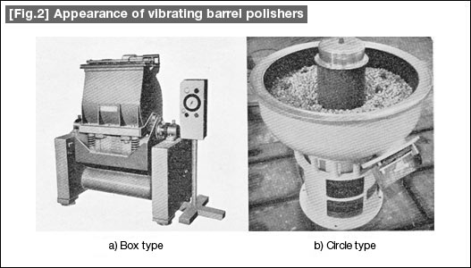

There are box type and circle type of vibrating barrels. The former performs one dimensional motion whereas the latter performs three dimensional motion.
The vibrating barrel, similar to the rotary barrel counterpart, also uses the parts and abrasives together in the barrel to polish.
The [Fig.1] shows the flow of the barrel contents, and [Fig.2] shows external appearances of the machines.
![[Fig.1] Flow of vibrating barrel contents [Fig.1] Flow of vibrating barrel contents](http://www.misumi-techcentral.com/tt/en/surface/images/123_01.gif)
In general, 7~5mm at 1,800~2,400cpm vibrations for heavy cutting. For gloss finish polishing, the vibration speed in increased to 2,000~2,800cpm while the amplitude is decreased to 5~3mm.
