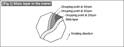

The rotary barrel polishing rotates the polishing agents and work pieces inside a tumbling barrel. As shown on [Fig.1], the top layer of the subject parts fall against the direction of the rotation creating a slide layer. This slide layer recirculates and polishes the entire batch uniformly.
![[Fig.1] Slide layer in the barrel [Fig.1] Slide layer in the barrel](http://www.misumi-techcentral.com/tt/en/surface/images/122_01.gif)
The amount of polishing varies depending on barrel rpm sue to changes in slide layer formulation. For normal polishing, 30~40rpm is appropriate, and 15~20 rpm for gloss finishing. Generally, when the barrel DIA is D [m] and barrel fill ratio is 55%, the polishing condition relationship is said to be shown as in [Table 1].

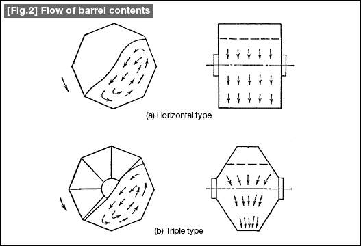

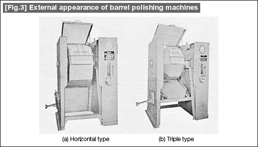

There are horizontal type and triple type of rotary barrel polishing. The triple type was supposedly named after the effects of the sides. [Fig.2] shows the flow of barrel contents, and [Fig.3] external appearances of the both.
![[Fig.2] Flow of barrel contents [Fig.2] Flow of barrel contents](http://www.misumi-techcentral.com/tt/en/surface/images/122_02.gif)
![[Fig.3] External appearance of barrel polishing machines [Fig.3] External appearance of barrel polishing machines](http://www.misumi-techcentral.com/tt/en/surface/images/122_03.jpg)
