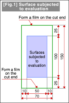

(2) Surfaces subjected to evaluation
| As shown in [Fig. 1], the surface with the specified sections removed from the test piece edge is subjected to the test. | ![]() |

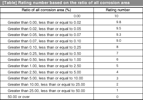

(4) Evaluation by actual measurement of corroded area
If the shapes of corrosion are too complex to check it against the standard drawings, actually measure the corrosion areas to determine the rating number in the following manner:
- Use a magnifying lens with magnification power of 10 times or more to look for the corrosion section larger than 0.1mm in shorter diameter and measure the longer diameter (d1) and shorter diameter (d2). Then calculate the corroded area by the formula: (d1 x d2 x π)/4
- Divide the total of corroded area calculated in step 1 by the area of the surface subjected to evaluation to determine the ratio of all corrosion area.
- Determine the rating number from the ratio of all corrosion area using [Table].
