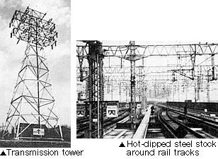

Various metals are used for hot dipping, such as zinc, aluminum, lead, tin plating, and composites of these metals. The most frequently used method is hot dip galvanizing, which is applied for a wide range of steel products, including various tubes, plates, wire ropes, metal meshes and more. In recent years, the industry has shifted its emphasis from a heavy, thick, long, and large structure to a light, slim, short, and compact structure. Owing to this industry trend, hot dipping rarely receives the attention it deserves, but it supports the industrial infrastructure by being used as a heavy-duty anticorrosion measure for transmission towers, large-scale bridges, and marine hardware. |

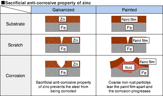

Hot dip galvanizing provides highly reliable corrosion resistance because of the property of zinc being electrochemically less noble than steel. Even when the substrate is scratched, a local battery is formed between the substrate metal and the plating metal where zinc serves as the sacrificial anode and protects the steel substrate from being corroded.Thus, the thicker the plating, the longer the product life.Because metals, such as tin/lead plating, being more electrochemically noble than steel will not serve as the sacrificial anode, the performance will be based on the anti-corrosive properties of the plating metals themselves.
