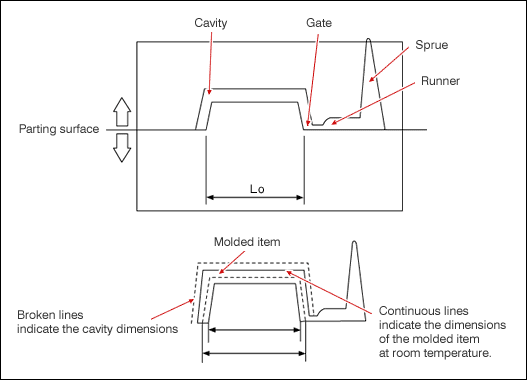

In the injection molding of thermoplastic plastics, it is possible to obtain a molded product with the desired dimensions using the mold shrinkage phenomenon. Mold shrinkage is the phenomenon where the volume of the molten plastic filled inside the cavity of a mold is shrinking at the time as being cooled and solidifying.
The extent of this shrinkage is called the "molding shrinkage factor", and if this molding shrinkage factor is known accurately both scientifically and by experience, by preparing the mold making the dimensions of the cavity a little larger by the amount of shrinkage, it is possible to form the molded item by so that it has the intended dimensions.
The value of the molding shrinkage factor is generally a number in the range of about 2/1000 to 20/1000 (about 0.2 to 2%).
If the molding shrinkage factor is expressed by the symbol α (alpha), it can be defined by the following equation 1.
