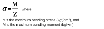

The symbol Z is used customarily for the section modulus. In general, as the section modulus becomes larger, the strength against bending also becomes larger. Regarding bending, the maximum bending stress σ acting on the outer surface of the part can be calculated using the following equation.
