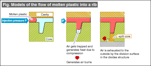

In plastic injection molding, some times burns occur at the end of thin ribs, etc., thereby causing a part of the molded product to become discolored black due to soot caused by burn.
The mechanism of burn is that, as the air inside the cavity of the mold is being vented out by the molten plastic that has entered the cavity it becomes trapped because there is no escape route for it, and because the air is compressed it generates heat and hence the plastic gets burnt due to the resulting heat that is generated. Since air is gaseous and generates heat when compressed, the trapped air generates heat. This is the same phenomenon as an air pump becoming hot when it is used for pumping air into a bicycle tire.
The compression of residual air inside the cavity is made in a very short time which is normally about 0.1 to 0.5 seconds, and also since it gets compressed to a very high pressure on the order of 200 to 500 kgf per square centimeter, the temperature rises easily to above the burning temperature of the plastic. (See Figure.)
The following countermeasures are useful for preventing burn.
![]() | 1. | When the part into which plastic flows is closed, place a core pin as a split structure of the cavity. There will be no generation of burn since the air escapes to the outside through the gap between the cavity and the core pin. Providing an air vent on the side surface of the core pin will be more effective. However, since parting lines will appear on the surface of the molded product in the case of this method, care should be taken because this method cannot be used in the case of molded products on whose surface such parting lines can not allowed. |
![]() | 2. | In the molding conditions, make the injection speed as slow as possible and fill the cavity gradually. Although this improves the situation in the case of very light air burns, care should be taken because this is not a fundamental solution to the problem. |
![]() | 3. | Carry out sufficient pre-drying of the material to be molded, and make sure that the condition is such that air does not get mixed inside the molten plastic. This too is not a fundamental solution to the problem so care should be taken. |
![]() | 4. | Change the wall thickness of the molded product or change the gate position thereby changing the flow pattern of the molten plastic and changing the position where air can get trapped. Although this method is effective, since the shape of the molded product and the weld position change, it is necessary to obtain the acceptance of the designer of the molded product. |
![]() | 5. | Change the injection speed selection position of the screw thereby changing the position where the air gets trapped. There are cases in which there are improvements using this method when the burn is light. |
