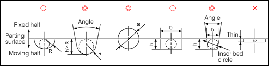

The runner is a path for making the molten plastic flow from the sprue to the molded product. The cross-sectional shape of the runner is selected depending on the size of the molded product, the type of plastic, the estimated molding conditions, etc.
The basic standards for selecting the runner cross-sectional shape are explained here.
The figure below shows some typical runner cross-sectional shapes.
The runner is selected from the following three types.
1)The type carved on the moving half
2)The type carved on the fixed half
3)The type carved on both the fixed half and the moving half.
The selection among these is made appropriately based on the restrictions imposed by the shape of the molded product, the mold parting position, etc.
The symbols in the figure have these meanings: image: Most suitable, image: Suitable, image: Not suitable
The most important role of the runner is to make the molten plastic flow in a condition in which no pressure loss is present. An unnecessarily large volume runner has the bad effects of increasing the scrap, worsening the material cost, lengthening the molding cycle, increasing the waste material, etc.
An index of the efficiency of a runner is the diameter and area of the inscribed circle in the cross-sectional shape. If the area of the inscribed circle increases, the area for hot plastic to flow becomes wide, and hence the molten plastic can flow easily.
Consequently, a runner with a circular cross section is the most ideal one. However, since it will be necessary to carve the runner in both the fixed side and the movable side, the cost of manufacturing the mold increases. In order to solve these problems, a rectangular cross-sectional shape runner or a runner with a semicircular cross-sectional shape that is made still deeper is used.
It is desirable to provide an angle at the side surface of the runner for separating from the mold. In addition, the inner surface of the runner is polished to a smooth surface using a rubber grinder or by carrying out lapping, thereby preventing pressure loss.
