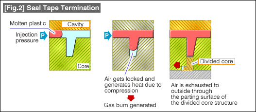

In plastic injection molding, a phenomenon can occur in which gas burns occur at the tip parts of thin ribs, etc., and a part of the molded product becomes black because of being carbonized.
The mechanism of generation of gas burns is that, at the time that the air inside the cavity of the mold is exhausted by the molten plastic flowing into the mold, if some of the air gets locked in a closed space, that air is compressed and gets heated by its own heat generation, thereby causing burning of the plastic.
Although air being a gas gets compressed, it generates heat when compressed. This is the same phenomenon as the pump becoming hot when it is used for filling air into a bicycle tire.
The compression of the air remaining inside the cavity occurs in a very short time of about 0.1 to 0.5 second, and since it is also compressed to a very high pressure such as 200 to 500 kgf/cm2, the temperature easily reaches the burning temperature of the plastic material. (See Fig.)
Fig. Model of flow of molten plastic into a rib
The following countermeasures are effective for preventing gas burns.
1.If the part into which plastic flows is in the closed state, use a divided structure and insert a core pin. Since air is exhausted between the cavity and the core pin, gas burns are not generated. It is more effective if an air vent is provided on the side surface of the core pin.
