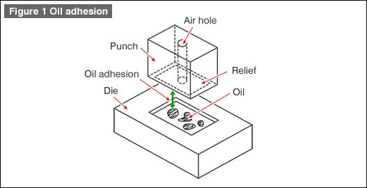

Cause of oil adhesion
The machining oil applied to the surface of the material makes the bottom surface of the punch come into close contact with the material, prevents the inflow of air from the periphery, and raises the material.
Oil adhesion countermeasures
| - | The supply of oil to the material is made large on the side surface of the die and made small on the punch side. | |
| - | -A relief is prepared on the bottom surface of the punch (the surface that comes into contact with the material) thereby making the contact area smaller. | |
| - | An air hole blowing weak air is prepared. (It is better to use this along with the above relief.) |

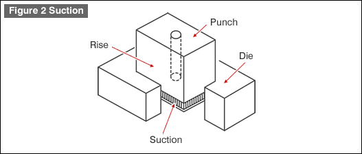

Cause of suction
During the process in which the formation is complete and the punch is returning, the material inside the die becomes a base and the punch becomes a piston, the pressure decreases in the space between the material and the bottom surface of the punch and hence the material is lifted up.
Suction countermeasures
| - | Since the pressure reduction is proportional to the punch speed, reduce the spm of the operation.。 | |
| - | Open an air inlet hole |
