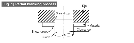

Blanking operations always result in generation of burrs. Because of that, burrs are very frequently removed by flattening the burrs. However, there are problems about Product Liability laws, and recently there is an increasing trend of removing burrs. One of the methods of eliminating burrs is given here. This method is generally called the flash pressing method.
In this method, to begin with partial blanking is done as shown in Fig. 1. Usually the punch is slightly larger than the die. This condition is called "negative clearance". By pushing the punch inside the material, the material is pushed inside the die and single sided shear droop is formed. The amount of pushing in by the punch at this time is very important, and should be 75% or more of the material plate thickness.
