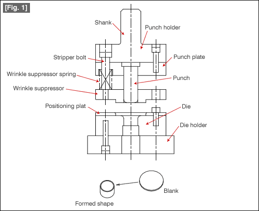

The most important parts of a die for drawing are the punch, the die, and the wrinkle suppressor. When drawing a cylindrical shape without a flange from a blank, a die of the drawing and dropping structure such as the one shown in Fig. 1 is used. The material to be formed is placed on the positioning plate, and after that material is drawn by the punch, the product is made to pass through the die and fall down. Even the die structure is simple and easy to prepare, and the die structure can be said to be one offering efficient press operation. The drawback is that the bottom part gets bent and it is difficult to make it flat.

Although this structure is easy to prepare compared to the structure of Fig. 1 using a spring, it is difficult to carry out manual press operation. This is used for simple type die for small volume production when used for manual operations. For mass production, the suitable structure is one in which automatic forming is done using a pusher feeder (an apparatus that carries out automatic forming by inserting into the die one sheet at a time from a pile of blanks that are pushed out by a plate shaped part carrying out reciprocating movement). Since quite a large force acts on the wrinkle suppressor, it will get warped if it is too thin. It is necessary to design it with a slightly larger thickness.
