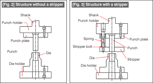

The structure of the drawing die will be as shown in Figure 2 to Fig. 4. The shape of the die is common to all the structures. This looks very weak. However, the inner diameter of the product to be drawn gets added to the external shape of the die, and in the process of drawing, the product moves so as to tighten the die and becomes a resistance to the force during drawing that tries to open the die outwards, and hence since a balance is achieved, breakage of the die is not common. It is better that the straight part of the die interior is as short as possible.

| Whether or not a stripper is necessary is determined by the relationship between the drawing diameter and the material plate thickness. If the material plate thickness is small compared to the drawing diameter, the structure becomes one like that shown in Fig. 4. This is because generation of wrinkles is suppressed at the part where the material makes U turn. | ![]() |
