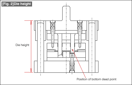

The die height of a press die is shown in [Fig. 2].

The die height is the height from the bottom surface of the die holder to the top surface of the punch holder in the condition at the bottom dead point when the punch and the die have mated together and the operation has been completed. In the case of a die with a structure in which the punch can penetrate the die to any extent, such as in the case of a blanking die, the depth of penetration of the punch should be decided and the height at that time is taken as the die height.
There are some people who call the die height of a press machine "shut height". The shut height is the distance from the bed surface (bolster surface) to the bottom surface of the slide under the same conditions as for the die height.
