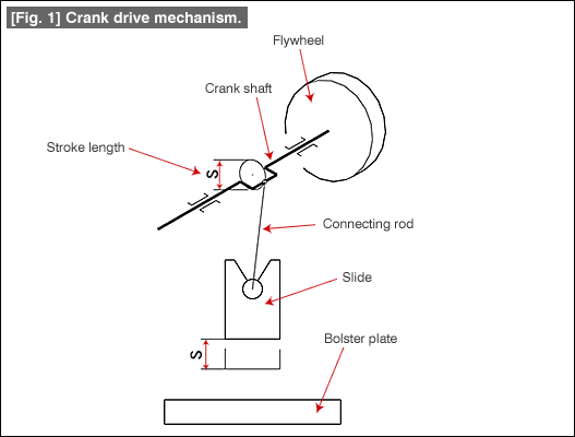

The crank type press machines (crank presses) that are used most frequently among all types of press machines have a structure such as that shown in Fig. 1.
The structure of this type is simple and this type is used widely because it is easy to manufacture. There is a form called eccentric shaft among crank shafts, but recently there is no particular preference being given to any shape of the shaft (because the completeness of the press machine becomes high and since it is possible to confirm that the required functions are being satisfied by checking the specifications).
