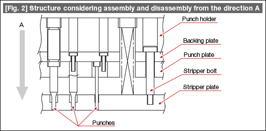

Fig. 2 is a structure in which the punch is fixed from the punch holder side. This is the method of fixing a punch seen very often in the case of dies having punches that are prepared by wire cut discharge machining. A round punch with a flange is fixed considering the ease of detaching it.

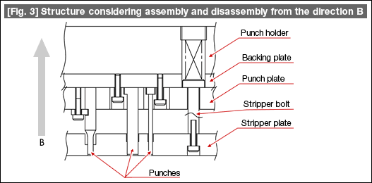

Fig. 3 is a structure that makes attaching and detaching the punch easy from the stripper side. When the punch material is an ultra hard alloy, very frequently fixing it using a key is common, and hence this structure is used very often.
The stripper bolt is a part that is related to the method of fixing a punch. It is good to match even the stripper bolt with the method of fixing the punch. There are some people who are afraid of using the stripper bolt (internal thread type) of Fig. 3 because it drops out, but there is no problem unless somebody has forgotten to tighten the bolt properly. Even measures for preventing loosening of the bolt have progressed, by using such improved bolts it is possible to obtain a still higher feeling of assurance.
