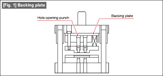

The backing plate is a very important die component which is also called a back up plate (perhaps this is a more accurate name), a back plate, or a backing, etc. It is used as shown in Fig. 1.
![[Fig. 1] Backing plate [Fig. 1] Backing plate](http://www.misumi-techcentral.com/tt/en/press/images/112_01.gif)
However, a backing plate is not necessary for all dies. When a large force acts on a small area such as in the case of a hole opening punch, the punch gets pressed and can dent the punch holder. A backing plate is necessary in such situations. It is not necessary as long as such a condition does not arise.
Because of this purpose of use, a certain amount of hardness is required of the backing plate, such as a hardness of about 56 HRC. If it is too hard, it can get cracked. Generally tool steel (SK steel) or special tool steel (SKS steel) is used.
