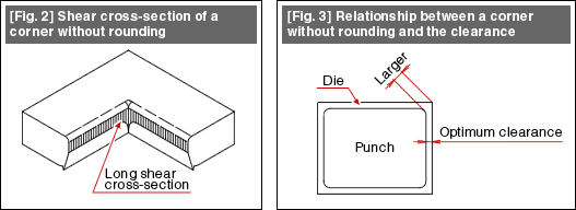

The above condition is the situation when blanking a shape having straight lines or gradual curves. At corners where two straight lines meet, even when the blanking is done using optimum clearance, the length of the shear cross-section extends to the entire plate thickness (Fig. 2). Under such conditions, there is the problem that the corner part of the punch wears out fast. If a rounding of 50% or more of the plate thickness is provided at the corner parts, the blanked state will be almost the same as in the straight line parts. When rounding cannot be provided at the corner parts, the clearance is made larger at the corners. This additional clearance is about 50% of the clearance used for the straight line parts (Fig. 3).
