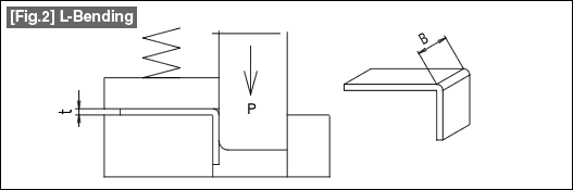

(2) Bending force for L-bending (see Fig. 2)
![[Fig.2] L-Bending [Fig.2] L-Bending](http://www.misumi-techcentral.com/tt/en/press/images/126_2.gif)
The bending force for L-bending is obtained using the following equation.
This shape is taken as the basis for the bending force for pad-pressed bending. In the case of U-bending such as shown in Fig. 3, since the bending line (B) is present at two locations, the above calculation is made by doubling the vale of the bending line length (B) in the above equation. |
In this manner, when bending is done in several locations at the same time, the total length of the bending lines is taken as the value of B.
