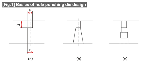

Fig. 1(a) shows the basic shape of a hole punching die.
Here, p is the die hole. It is made larger than the punch by the amount of the clearance between them. (See Lesson 5 which discusses the clearance in blanking operations.) B is the part which is called the die cutting edge length. This is determined considering the re-grinding margin. If we assume that the thickness of the work material is 1cm, the state in which 3 to 4 scraps have got accumulated is good. It is not good if this die cutting edge becomes too long, because it can lead to jamming of the scrap. Further, d is the scrap ejecting part. It is said that scrap jamming can occur easily when the dimension d is about twice the dimension p. The countermeasures for this are the shapes (b) and (c). A taper is provided thereby making it difficult for scrap to stick. The shape (c) is one in which the shape is made larger in small steps when it is difficult to machine the taper. This can be said to be a substitute for tapering.
