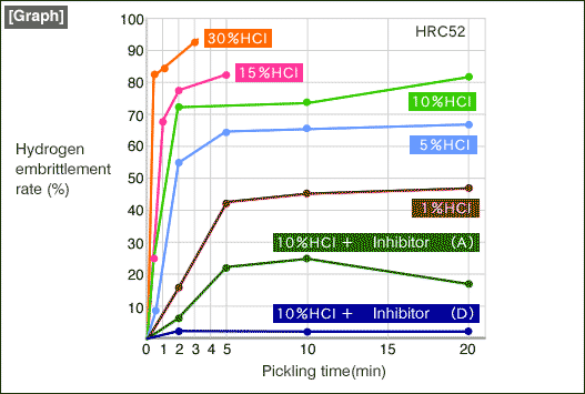

Carbon steel's hydrogen embrittlement rate per process is shown next.
(1)Pickling
The pickling process is performed to remove scales and rust from the surface of steel objects to be plated. Normally, this process uses hydrochloric acid, sulfuric acid and the like, and prone to cause hydrogen embrittlement. If this process is performed unconscientiously, the steel will certainly absorb hydrogen and embrittlement induced fracture will occur. For high tensile strength steel applications where safety is strongly desired, dry processes such as shot blasting and honing are therefore often specified.
(2)Pickling by hydrochloric acid
Pickling bath most typically used for steel alloys is at 10% solution strength, and the steel immersed in this bath in just a few minutes will reach 70% hydrogen embrittlement rate (see [Graph]). This is a significant problem for high tensile strength steel. Higher hydrochloric acid concentration will further raise the embrittlement rate. The immersion rate versus time will saturate beyond a few minutes. In order to prevent this problem, commercially available inhibitors are usually added to the solution. The inhibitors will be mentioned later.
