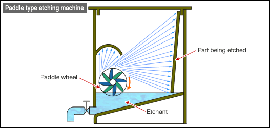

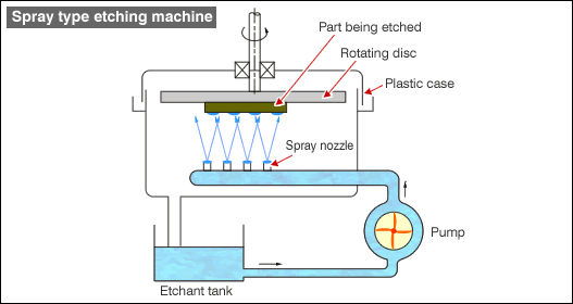

(2) Through-material etching
There are two application methods: Immersion type and Spray type. With the immersion type, the part is immersed in the corrosive liquid, and the liquid is constantly stirred. Air injection is the widely used stirring method.
The spray method of etching employs specially designed etching machines. Spray type machine has nozzle(s) that spray the etchant, and Paddle type has a rotating wheel with paddles that spray the etchant. Both types are made in vertical and horizontal configurations, as well as single sided etching and dual side etching types.
