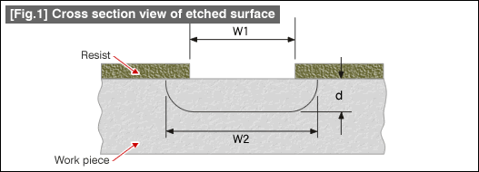

A point of caution for etching process is Side Etch. The corrosion of etching process advances vertically as well as horizontally. The horizontal direction advancement is called Side Etch (s), or Side Cut. The figure [Fig.1] below is a cross sectional view of etched surface. The area of side etch (s=(w2-w1)/2) increases as the etching depth (d) increases.
Nature of the side etch phenomena vary with the metal property, composition of etchants, and etching conditions. Little issues exist when the metal thickness to be etched is small (i.e. several micrometers), but thicker metal will be troublesome.
To minimize the side etch effects, selecting proper etchant becomes important. Etchants with corrosion inhibitors are often used. Etching methods also affect this. The spray type and paddle type etching systems where the etchant is applied perpendicular to the targets will result in smaller side etch as compared to immersion etching method.
