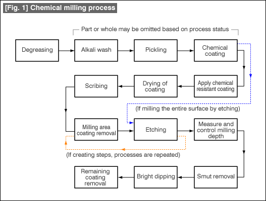

Chemical milling is also called "Chemical contour machining", and is a metal milling technique by utilizing chemical etching process. With this technique the etching depth is limited to the thickness of the material to create three dimensional features, unlike through etching techniques.
Chemical milling typically follows a process shown in [Fig.1]. There are four major process blocks: Pre-process; Masking; Etching; and Post process.
![[Fig.1] Chemical milling process [Fig.1] Chemical milling process](http://www.misumi-techcentral.com/tt/en/surface/images/030_1.gif)
When milling the entire surface by etching, proceeds directly to the etching process since the masking process is not needed. When creating steps on the surface, multiple "etch and mask removal" processes are repeated.
