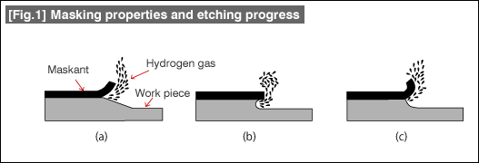

In scribe and peel method, the masking material is required to have different characteristics compared to the other methods since the masking on the substrate is hand peeled. For the other methods, properties such as corrosion resistance, applicability, durability, adhesion strength are of the utmost importance. But for the scribe and peel method...
(1) Flexibility
(2) Surface adhesion strength
will need to be of proper mid values. This is shown in [Fig.1].
![[Fig.1] Masking properties and etching progress [Fig.1] Masking properties and etching progress](http://www.misumi-techcentral.com/tt/en/surface/images/032.gif)
The combination of flexibility and adhesion strength is important. If the masking is not thick enough or not adhesive enough, it will peel off the surface and will cause increased side etching [Fig.1](a). If the masking is excessively thick or lacks flexibility, gas will collect beneath the masking and cause an over-hang [Fig.1](b). When the masking has the appropriate adhesion and flexibility properties, a well controlled milled cross section is obtained as can be seen in [Fig.1](c).
