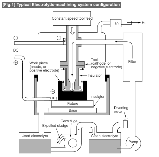

(2) Configuration of a Electro-machining system
A typical electro-machining system configuration is shown in [Fig.1]. As seen in [Fig.1], the work and the tool (electrode) is held very closely (0.02~0.7mm typical) to each other. A DC current is applied to the work as an anode (positive) and the tool as a cathode (negative) through the electrolyte.
![[Fig.1] Typical Electrolytic-machining system configuration [Fig.1] Typical Electrolytic-machining system configuration](http://www.misumi-techcentral.com/tt/en/surface/images/034.gif)
Normally, the voltage used is 5~20V, and current density is 30~200A/cm2. This voltage/current level is quite high in comparison to Electrolytic-polishing and plating. The higher voltage and current results in faster process speed, improved accuracy and better surface roughness.
In order to constantly maintain a fixed positive/negative electrode distance (process gap), the cathode is fed into the work piece. The feed speed is 0.5~10mm/min based on the current density specified. As the result, the work piece is milled in a shape inverse of the tool (cathode) shape.
When the current is applied, hydrogen gas is formed from the cathode surface, and dissolved product from the anode surface. Also, the electrolyte temperature rises due to Joule heating by the electrical current application. If the electrolyte temperature reaches a boiling point, controlling of the electrical current becomes impossible. It is important to remove these negative factors immediately. To do this, the electrolyte is forced to flow between the electrodes at high speeds by the recirculation pump at 6~60m/S, typically.
The used electrolyte falls into the storage tank, then the impurities are let sedimented, centrifuged, filtered, and cooled down. The clean electrolyte is reused.
