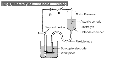

8) Electrolytic micro-hole machining
Although micro-holes can be created with electrodes made of small diameter metal tubes with outer insulation, the insulating of this outer surface is difficult and the insulation at the tip is easily broken during the process.
In order to overcome this shortcoming, a scheme shown in [Fig.1] is used. The surrogate electrode is made of an insulating material such as glass tube with a fine tip, connected to the cathode camber with a flexible tube.
![[Fig.1] Electrolytic micro-hole machining [Fig.1] Electrolytic micro-hole machining](http://www.misumi-techcentral.com/tt/en/surface/images/021.gif)
The actual electrode (metal rod or plate) is immersed in the electrolyte within the cathode chamber. Approximately one atmospheric pressure is applied to the cathode chamber to cause the electrolyte to fill and flow from the fine tip (fewμm) of the surrogate electrode.
The tip is placed very close to the work piece and the electrical current applied. The electrolytic etching occurs only at around the tip, and by advancing the tip position into the work piece as the etching progresses, the micro hole can be bored.
Since a constant electrical current will remove a certain amount of material in a certain amount of time, a hole with a constant diameter can be created by advancing the tip at a constant speed.
