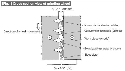

(2) Grinding wheel electrode
In electrolytic grinding, the total amount of material removed can be divided into the amount removed by mechanical grinding and electrolytic elution. The amount removed by the mechanical grinding is very small as 1~2% for carbon steel, and 10~16% for carbide, while most material removal is by the electrolytic elution. [Fig.1] shows the cross section view of the grinding wheel.
![[Fig.1] Cross section view of grinding wheel](http://www.misumi-techcentral.com/tt/en/surface/images/024_1.gif)
The grinding wheel is composed of non-conductive abrasive particles and binder material (mostly metallic). The non-conductive abrasive particles protrude by a small amount (typically 0.02~0.05mm) from the surface of the conductive binder material. The insoluble anodic byproducts on the surface is ground off by the abrasive particles to allow the conductive binder material to continue the electrolysis on freshly exposed metal surfaces. This also sets the machining gap.

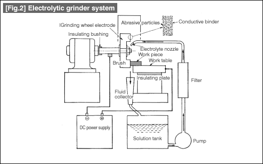

(3) Electrolytic grinder system
[Fig.2] shows an example of a electrolytic grinder system. Electrical current flows from: positive side of the DC power supply > work table > work piece > electrolyte (working gap) > brush > negative side of power supply. The electrolyte is sprayed onto the frontal surface of the wheel, then the centrifugal force of the rotating wheel feeds the electrolyte into the working gap.
